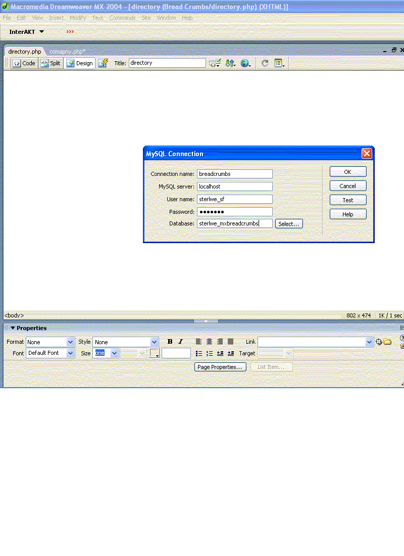

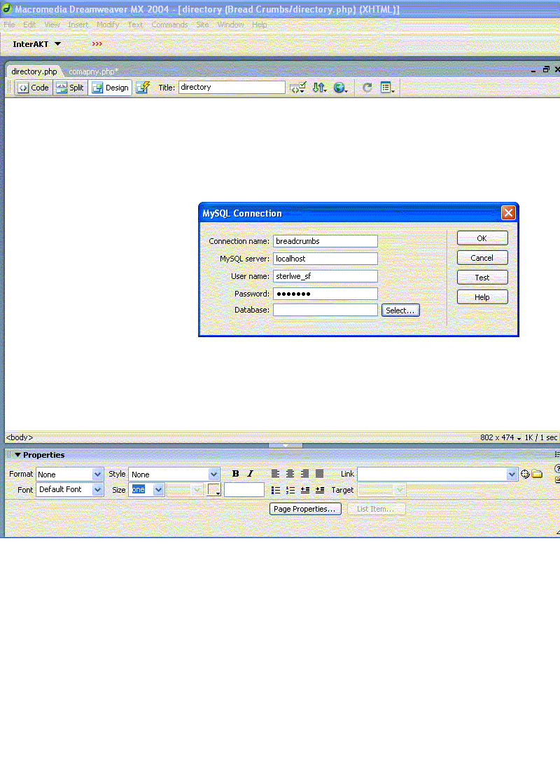

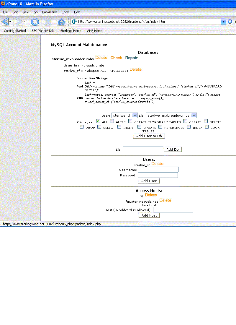

acsteve Posted October 14, 2005 Author Posted October 14, 2005 (edited) Ok I will try posting these 3 pics in an effort to show what i am looking at and see if any one can see where i am going wrong. Please take a look and let me know if you see my mistake. thanks Steve PS Very sorry did not mean to start a new tread. I was in feeling defeated and clicked new topic guess i messed up.... Thanks Steve Attached thumbnail(s) Edit by TCH-David: Post merged from separate topic. Edited October 15, 2005 by TCH-David Quote
GroovyFish Posted October 14, 2005 Posted October 14, 2005 Steve, I'm sorry that you still aren't up and running with this. I did an google search and I did find a couple of places that said that you should make sure that your ISP isn't blocking port 3306. Now I know you have tried this from home and work without success, so it is likely not the problem, unless you use the same ISP from home and work, but I thought I would throw it out there as something to check on. GroovyFish Quote
GroovyFish Posted October 14, 2005 Posted October 14, 2005 Another thought crossed my mind. I know that you said you don't have a static ip, but, it would be interesting to find out what would happen if you add your current ip address in the Access Hosts field in Cpanel and try to connect. Quote
acsteve Posted October 14, 2005 Author Posted October 14, 2005 Once again thanks again groovyfish for your help. Right about the office and home being 2 different isp's. One is dsl and the other is cable. I am trying to remember though how to find my ip address that i have right now and add it to the host access.... will try soon as i find.. Thanks Steve Quote
GroovyFish Posted October 14, 2005 Posted October 14, 2005 Just go to www.whatismyipaddress.com to get your current IP address. Quote
acsteve Posted October 14, 2005 Author Posted October 14, 2005 yes i went to command prompt typed in ipconfig got it, tried it and no go. This is really a joke hu? how can this be?? thanks Steve well hang on i went to ythe site you gave me and it has a completly different address sooooooo let me go try this one no go once more it did take a little time though and i thoght for a minute that it was going to work. It actually said testing connection server but then the same old 404 not mapped etc.. Quote
