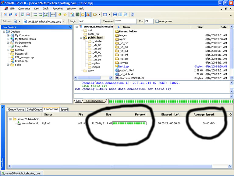

Head Guru Posted June 16, 2003 Posted June 16, 2003 I have looked at server26 and find no issues at all with the performance of the server. I was able to upload a 12MB file using smartftp without issue. The upload maxed out my DSL line. Once it was done I was not disconnnected. I also downloaded ws-ftp pro. Right off the bat I must say what a gosh awful GUI this program has. Anyways I installed the demo using all the standard settings. I was able to successfully upload a 20MB file without issue. This also maxed out my DSL line. Quote
Head Guru Posted June 16, 2003 Posted June 16, 2003 As you can see from my screen shots, this issue does not appear to be server side. Here is what we need you to do. Answer the following: Are you behind a firewall? Did you use the standard install of ws-ftp? Have you tried another FTP client? Post a tracert from the computer with the ftp problems to server26.totalchoicehosting.com Quote
jonestx Posted June 16, 2003 Author Posted June 16, 2003 The issue isn't FTP speed. Speed is fine once it connects. Yes, I'm behind a ZoneAlarm firewall, but disabling the firewall doesn't correct the problems. I get the same results with my registered WS-FTP Pro, with the trial version of CUTE-FTP and the free program Filezilla. Tracert times look fine. Connection to TCH in all aspects is fine, web performance, connection to email, even the initial FTP connect, all normal. It's that 20-30 second DELAY after the connect before anything happens, and the frequent disconnects, that are annoying. I found the same delays when using my laptop from work with a dial-up account. Initial connection was fine, but a delay after any FTP command is issued before it actually takes effect. Quote
Head Guru Posted June 16, 2003 Posted June 16, 2003 Its not happening to my connections at all. I uploaded 32MB of data without a disconnect. Please provide a tracert as requested. Quote
