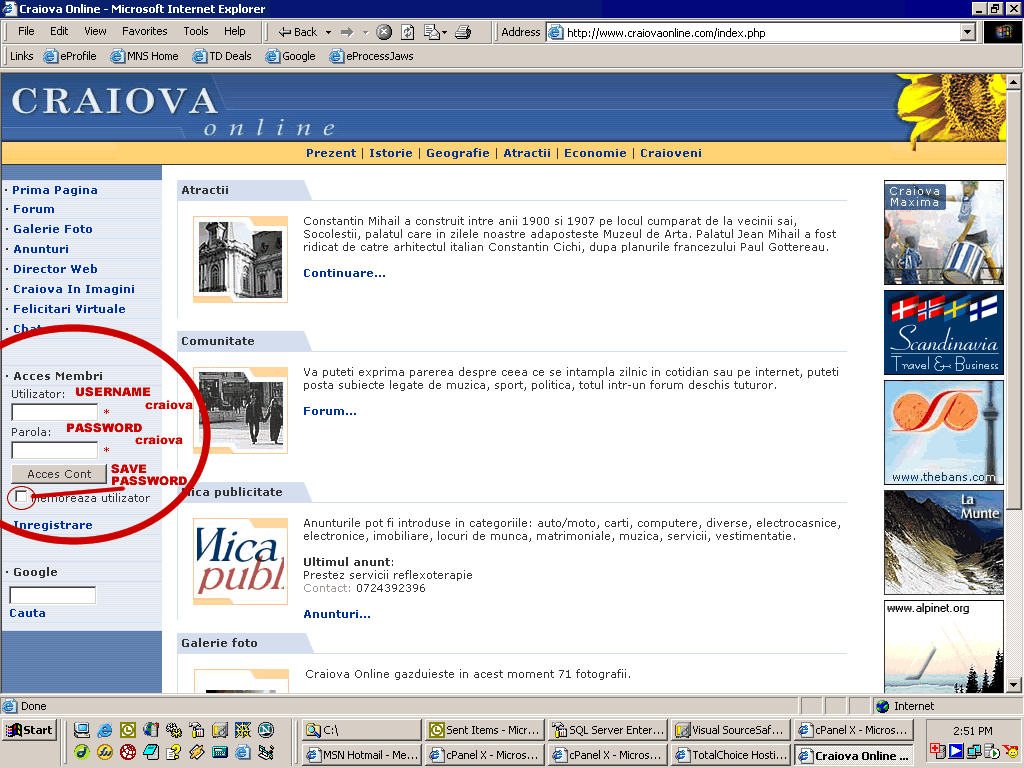

msdan Posted June 16, 2004 Posted June 16, 2004 Suddenly, when I'm trying to access my site I'm getting the password protected screen: Enter Network Password Site: server70.totalchoicehosting.com Realm: Web Host Manager This is happening only when I'm opening the first time the browser. If I'm clicking Cancel and call again the site it is working. If open a new window and call again the site I'm getting again the screen protected. http://www.craiovaonline.com PS: If you click the link from this post the site is working. You have to open a new window and paste the address in this new window. Quote

msdan Posted June 17, 2004 Author Posted June 17, 2004 I cannot figure out what's happening to anybody from TCH - if you have time, please test a bit - maybe you can see if you get the screen. I have to explain the steps because the site is not in english:(: - see the left side of the screen shot - go to www.craiovaonline.com - use for username: craiova - use for password: craiova - check the box Save Password - login - close the browser - call www.craiovaonline.com again (now you should get the popup) - click cancel on the popup window - call www.craiovaonline.com - now should work I want to get rid of the popup Quote
