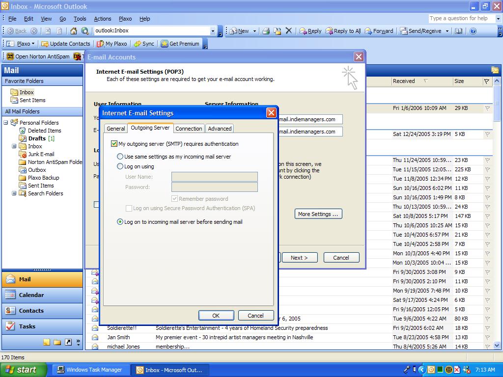

TCH-Bruce Posted January 15, 2006 Posted January 15, 2006 Looking at your image you have Outgoing server requires authentication checked but neither radio button under it is selected. I'd select the first one and try it. If that doesn't work, select the second one and enter your email address and password for the account. Quote
