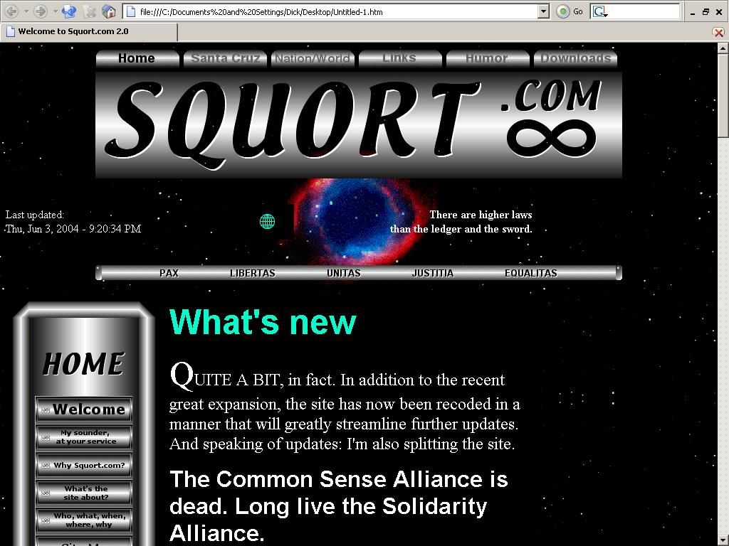

The only issue that I can see is with your flag image. It will not stay centered.
This image is from 1024 x 768
Thank you, Dick.
The reason the flag doesn't center, I think, is just that I haven't inserted a <div align=center> tag ahead of the main table yet.

I think I've fixed the centering problem.
May I ask those of you who use high resolutions (above 800 x 600) to examine the site and let me know if it looks all right?
