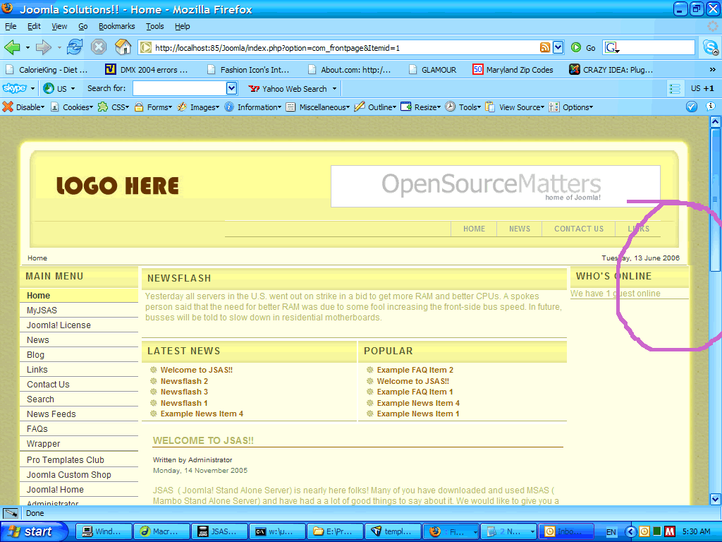

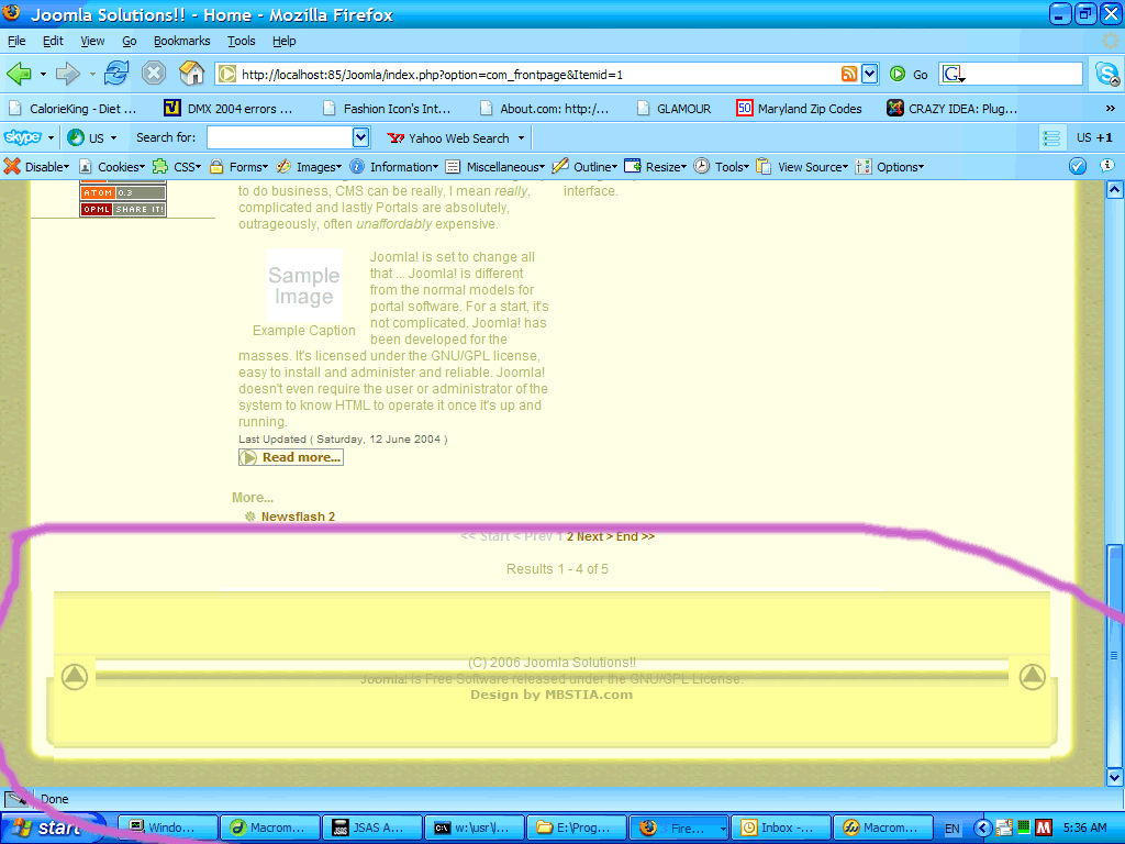

I have run into a strange error where my layout's sides aren't in the right place (they are off a bit) and my bottom (footer) image seems to be repeating itself in a strange manner. I can't figure out what I have done wrong. :surrender:
I have attached an image of the top and of the bottom of my layout so you can see what is happening. See pink circled areas.

Nat,
I have fixed this problem for you.
Issues where, bottom table was not set out correctley. When dealing with images as backgrounds in tables, its always handy to start specifing exact heights and widths. Also I have added an extra class in to help out.

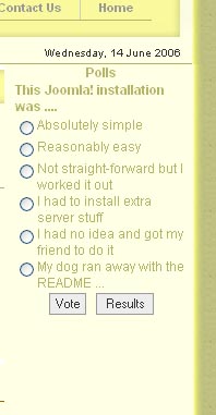

The other issuse was just increasing the padding from 8 to 10 on that side.
The attached is a redone template, just remember to delete the original template before uploading!
JimE
premiersound.zip
