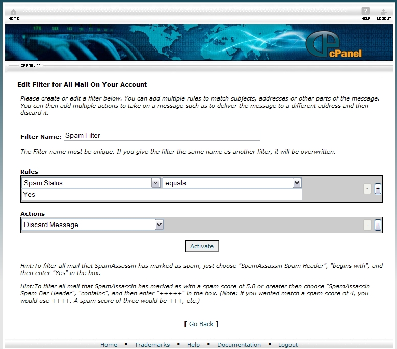

If you want special handling for spam, you should create an email filter.
Go to cpanel > Email > Filters > Add Filter. There should be a "Hint" on that page:
To discard all email that SpamAssassin has marked as spam, follow the hint: Condition = "SpamAssassin spam header" starts with Yes. Destination = discard.
If you're worried that legitimate mail might be discarded, you should instead create a separate real email address in your account, whose only purpose is to receive spam. Then go to Add Filter and set that as the destination. Everything arriving in that inbox is something that SpamAssassin considered spam. It's presorted. You can quickly review it for legitimate mail and then delete all the rest of it.
(I do not recommend using Spam Box, which is an option you see on the SpamAssassin setup page. Spam Box is not a "real" email address, so it lacks the flexibility that a real email address has. It cannot be further filtered or forwarded, for example.)
Hey Thomas,
I just checked my filters and I don't see a "SpamAssassin Spam Bar Header" choice in the drop-down.
