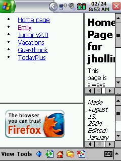

jhollin1138 Posted February 24, 2005 Posted February 24, 2005 (edited) I'm still learning HTML by the old "trial and error" method. I need some help trying to do something. A few weeks ago I added frames to my website so I can add a frame for navigation. It works great with a full screen PC browser. The problem is that I host a "Pocket PC" forum for a program called "TodayPlus." (I didn't write the program and its history is an interesting story.) I get some visitors to my site directly from their "Pocket PC" and the frames make viewing my site nearly impossible. Here is what it looks like. I am not sure how to do it, but I believe you can determine which browser a visitor is using. I am assuming it is basically an "if...then...else..." statement. After making this determination, I can then change your layout accordingly. So if I can figure out how to do it, I can revise my frames to make a more Pocket IE (PIE) friendly site. So here are my questions. 1) What is the format for testing for which browser is being used? 2) Instead of determining the browser, can I determine the operating system? BTW, the version of PIE on my Pocket PC doesn't support CSS and that is another problem all together. Edited February 24, 2005 by jhollin1138 Quote
