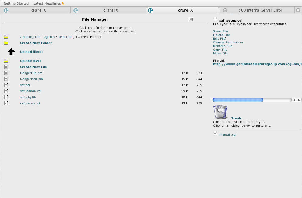

I'm testing out a perl script, all I need to do is upload the files, change 1 line of code, and chmod.
I've double checked that I'm uploading all *.cgi as ASCII and I know that I've chmod correctly! I also tried the trick of playing with the file in the Cpanel file editor and saving it to see if that helps, but I still get this error:
File does not exist: /home/melanie/public_html/404.shtml
File does not exist: /home/melanie/public_html/500.shtml
Premature end of script headers: /home/melanie/public_html/cgi-bin/selectfile/saf_setup.cgi
I also know that the path to perl is correct in the first line: #!/usr/bin/perl
Is there anyone that can offer some help? I've installed dozens of scripts before without an issue...but this perl stuff is killing me! I feel slightly dumb now!
Thanks everyone!
Here's the web address to the script:
http://gamblerealestategroup.com/cgi-bin/s...e/saf_setup.cgi
I'll also attach an image of the cpanel file manager of the folder within the CGI-Bin

I had TCH-Rick have a look and he discovered this:
Bad name after adminemail' at saf_cfg.lib line 31.
Compilation failed in require at ./saf_setup.cgi line 65.
So it looks like there is something wrong with the saf_cfg.lib file. I don't know if that is much help but you can go back to the site where you purchased the script and ask them.
Or you may want to remove all of it and start over.
